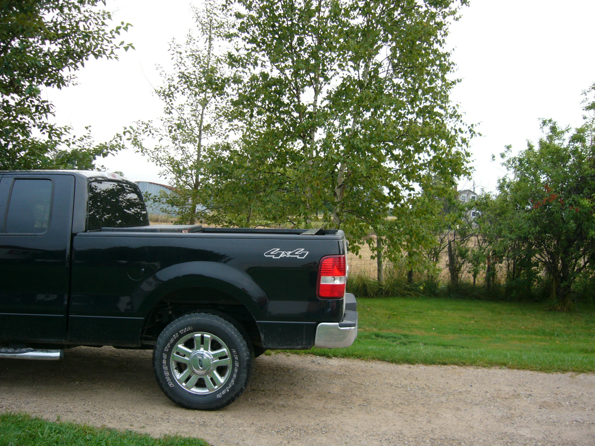

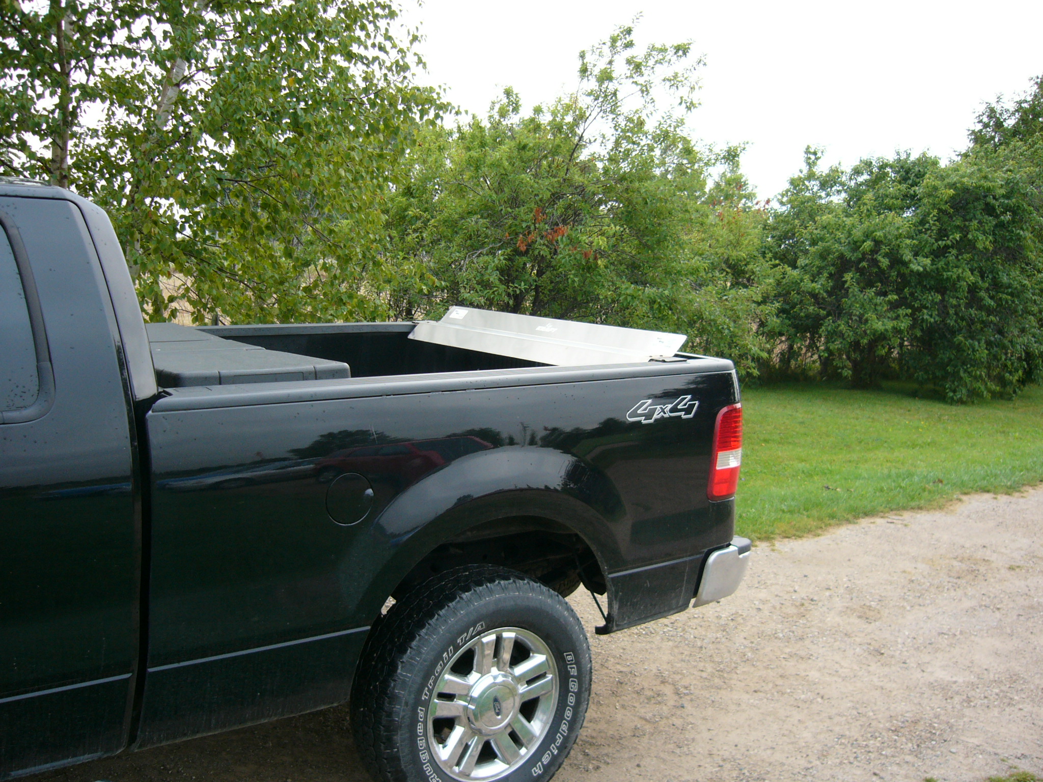

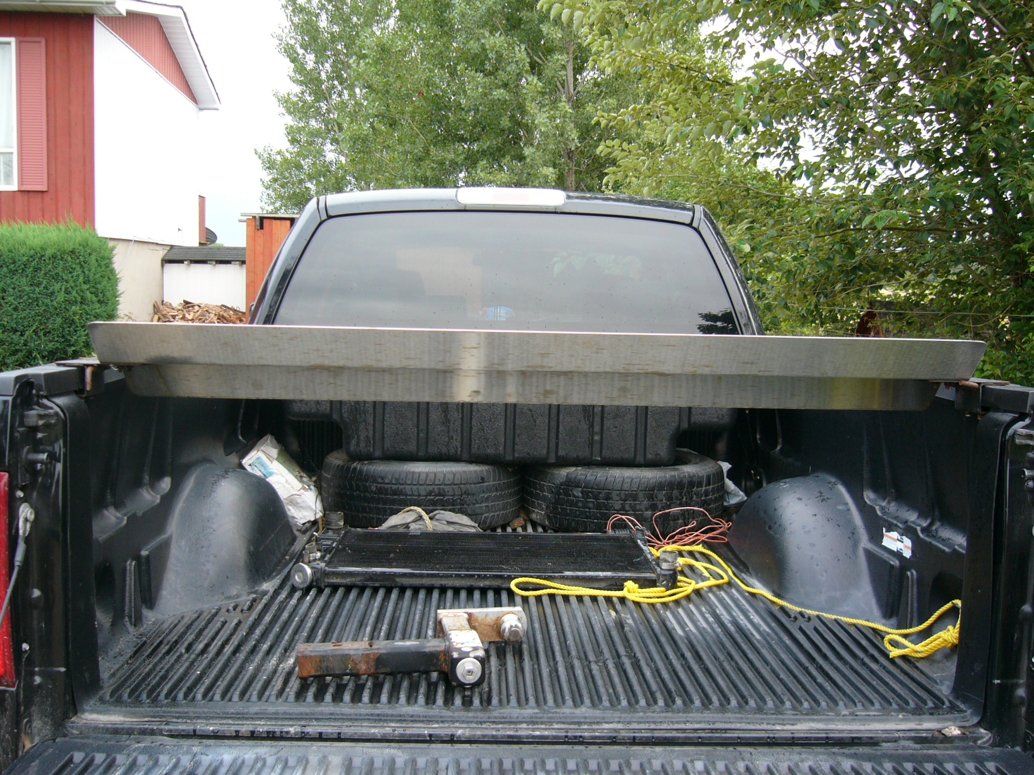

Im in the middle of moving offices to our new building, when I can get the chance to look through everything and find the paperwork i'll share it with everyone.
I can remember on one of the test trucks, which was a 2008 F150 4x4 ext cab with 4.6 v8 its rated at roughly 17 highway, with no other addition except the device called the "Areo Wing" The mileage was averaged at 25 mpg.
a 2006 gmc Canyon 4x4 crew cab with the 5cyl rated at 22 highway, averaged almost 30 on highway, and 25 in the city.
off the top of my head that's all I can remember without looking up the results, we've got 3 more trucks that are still being tested.
these are the pics of the ford that's sitting in the driveway. the wing is made of stainless steel, the next generation of mounting hardware is also going to be stainless. its designed with a quick detach pin system that takes less than 30 sec to take the wing off.
the wing and hardware is patented.

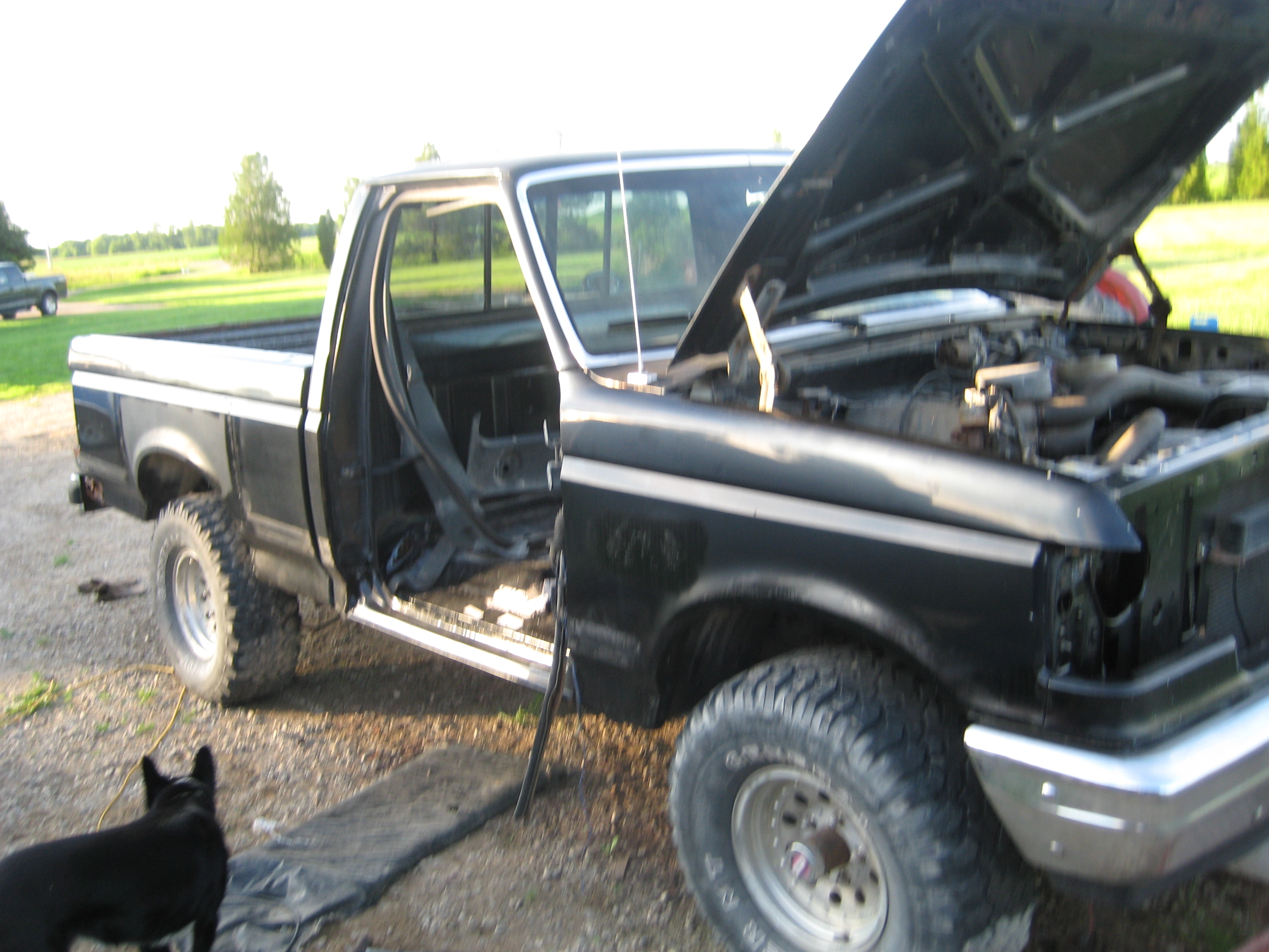

this was it while I was still in restoration mode.
its on 33x12.5x15 general grabber m/s tires with the 15x7.5 ford aluminum rims.
completely stock suspension.
after I got it put together and running I took it through the mud hole a couple of times.
I never hit the fenders and I didn't get any problems with those tires . at full turn the corner of the tread will rub on the radius arms but I got that even with 31's.
