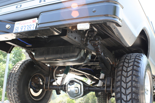

Here is what it looks like on a 73 F250:
