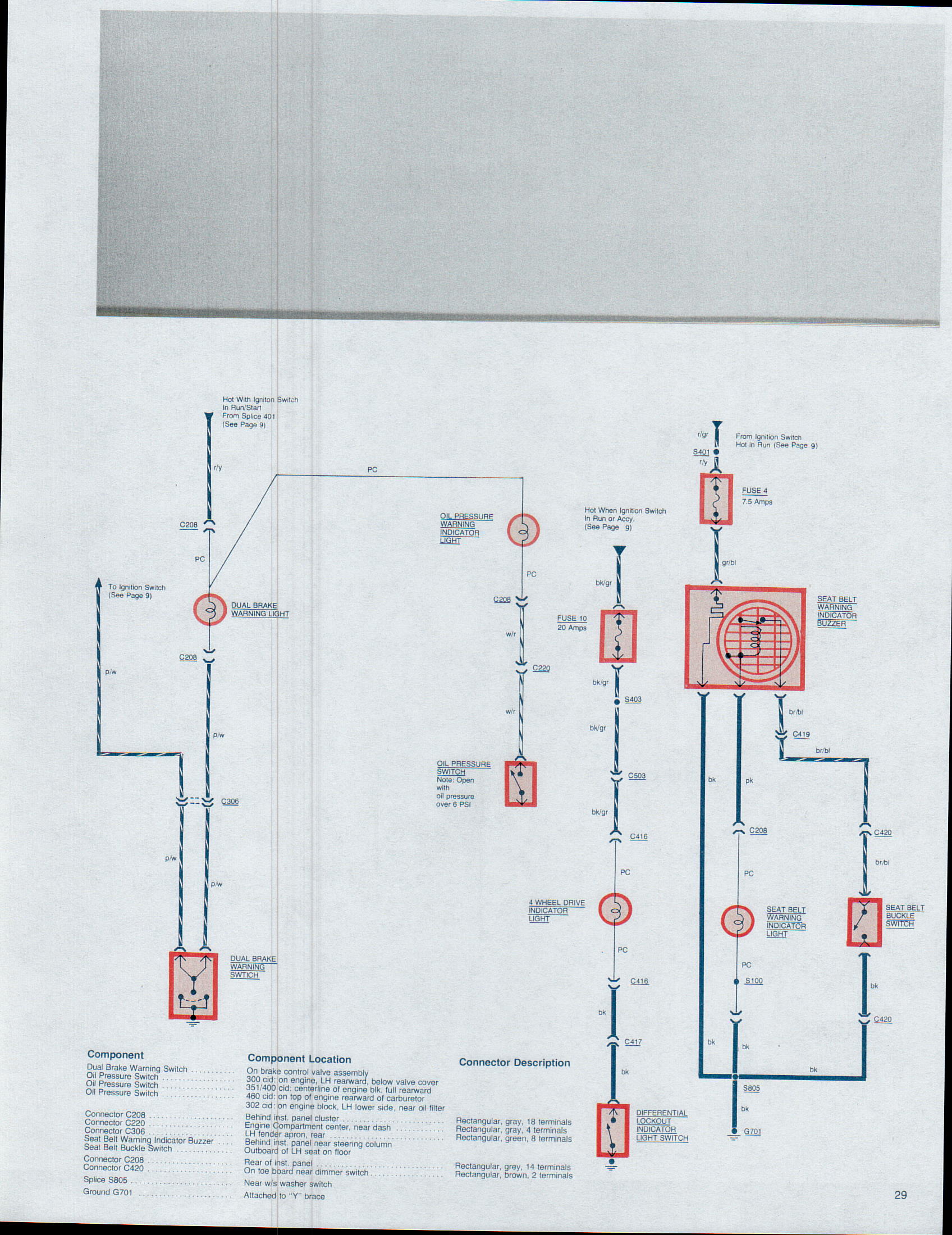

Yo,
Can only post one pic at a time. 1979-bronco-f100-through-f350_page_29.jp
