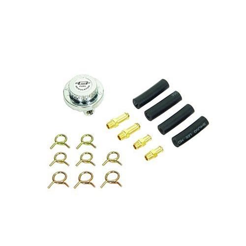

Selling parts for many years and ran my own shop and was a service manager even more. Electric pumps are PUSHERS, not SUCKERS. they should almost always be mounted on the frame as close to the tank as possible. The pumps will work while in the forward part of the truck, but they will burn out prematurely. Watch the pressure of the pumps too. the last thing you want is a pump that overwhelms the carb, Edelbrock make great carbs, but they do not take even factory mechanical pump pressure well. I sell and install a Mr Gasket fuel pressure regulator with every Edelbrock i sell. I know the original post talked about a Holley, they are fine, but someone else reading this should know there is a big chance that later on an Edelbrock could be in the cards or may have one themselves.
Mr Gasket #9710
Posted Image
